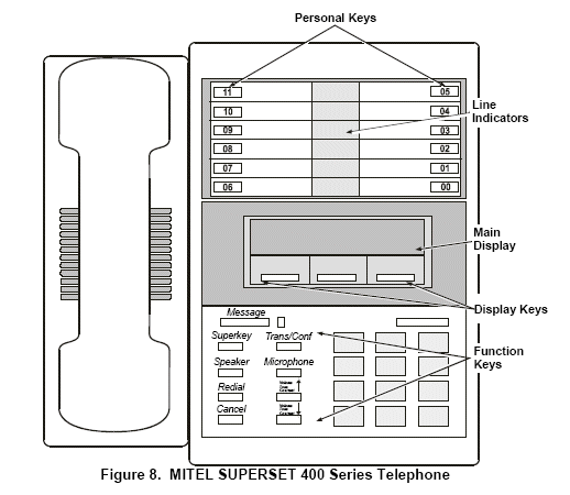

The "$Kd" prefix you used is a command that the 'Bottom Left Softkey' should be pressed - and it looks like 'Bottom Left Softkey' was set on this extension to act as the 'Blind Transfer' key.
You can issue commands to use other keys as well:
"$KA" represents 'Personal Key 00'
"$KB" represents 'Personal Key 01'
... etc, etc ...
"$KK" represents 'Personal Key 10'
"$KL" represents 'Personal Key 11'
furthermore, on a Superset 430:
"$KM" represents 'Message Key'
"$KN" represents 'Super Key'
"$KP" represents 'Microphone'
"$KQ" represents 'Hold'
"$KR" represents 'Applications'
"$KS" represents 'Speaker'
"$KU" represents 'V/T/C up'
"$KV" represents 'V/T/C down'
and
"$Ka" represents 'Top Left Softkey'
"$Kb" represents 'Top Middle Softkey'
"$Kc" represents 'Top Right Softkey'
"$Kd" represents 'Bottom Left Softkey'
"$Ke" represents 'Bottom Middle Softkey'
"$Kd" represents 'Bottom Right Softkey'
which key is which is shown on the diagram at bottom of this post.

Diagram of the MITEL Superset 400 series phone:
